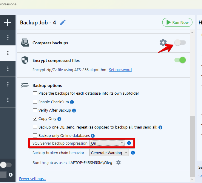

To reduce the execution time of the backup process in your case, please consider the following recommendations:
  • Disable compression in the backup job and instead enable native SQL Server compression for database backups (see the screenshot for reference).
  • Increase the number of parallel threads in the S3 destination settings beyond 4 and test if a higher value improves upload speed.

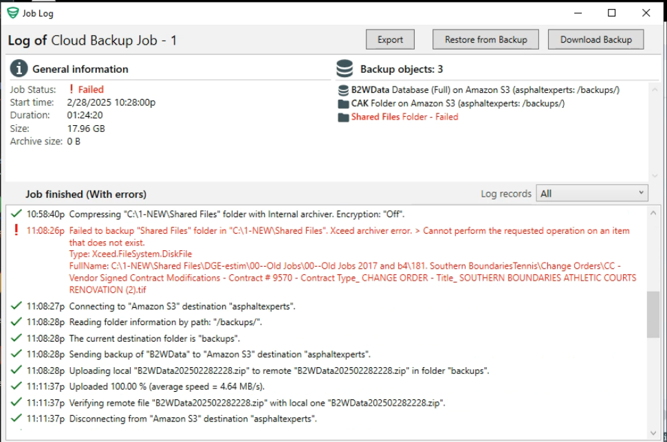

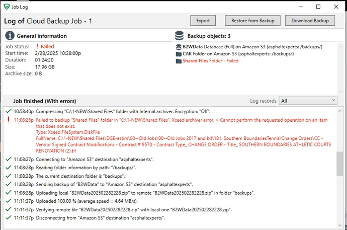

I’m also having problems with this backup job because I’m backing up the SQL database as well as some shared document files. I get random error messages for certain files that I know exist. This causes the backup to fail for the shared document files. See the screenshot.
Thanks.

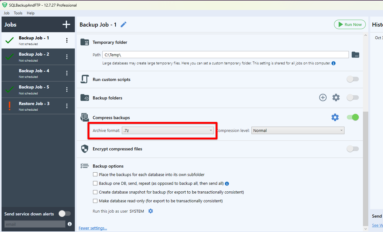

To resolve the issue, please try using 7zip compression for your backups instead of zip. You can configure this option in the “Compress backups” section of your backup job settings (see the attached screenshot).
