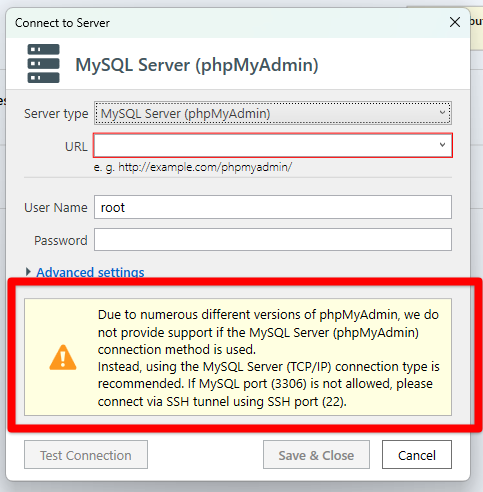

Hello Gregory,
Thank you for your response and details.
Currently, due to the numerous different versions of phpMyAdmin, we are unable to provide support when the MySQL Server (phpMyAdmin) connection method is used. Instead, we recommend using the MySQL Server (TCP/IP) connection type for a more reliable connection. If the MySQL port (3306) is not accessible, you can connect via an SSH tunnel using the SSH port (22).
phpMyAdmin_SQlBackupAndFTP
I can’t use MySQL Server (TCP/IP), I don’t have permissions.
I have to use another backup method e.g. WordPress plugin.
Thank you for your response.
Unfortunately, without permissions to use the MySQL Server (TCP/IP) connection, it is not possible to back up your database using SQLBackupAndFTP.
