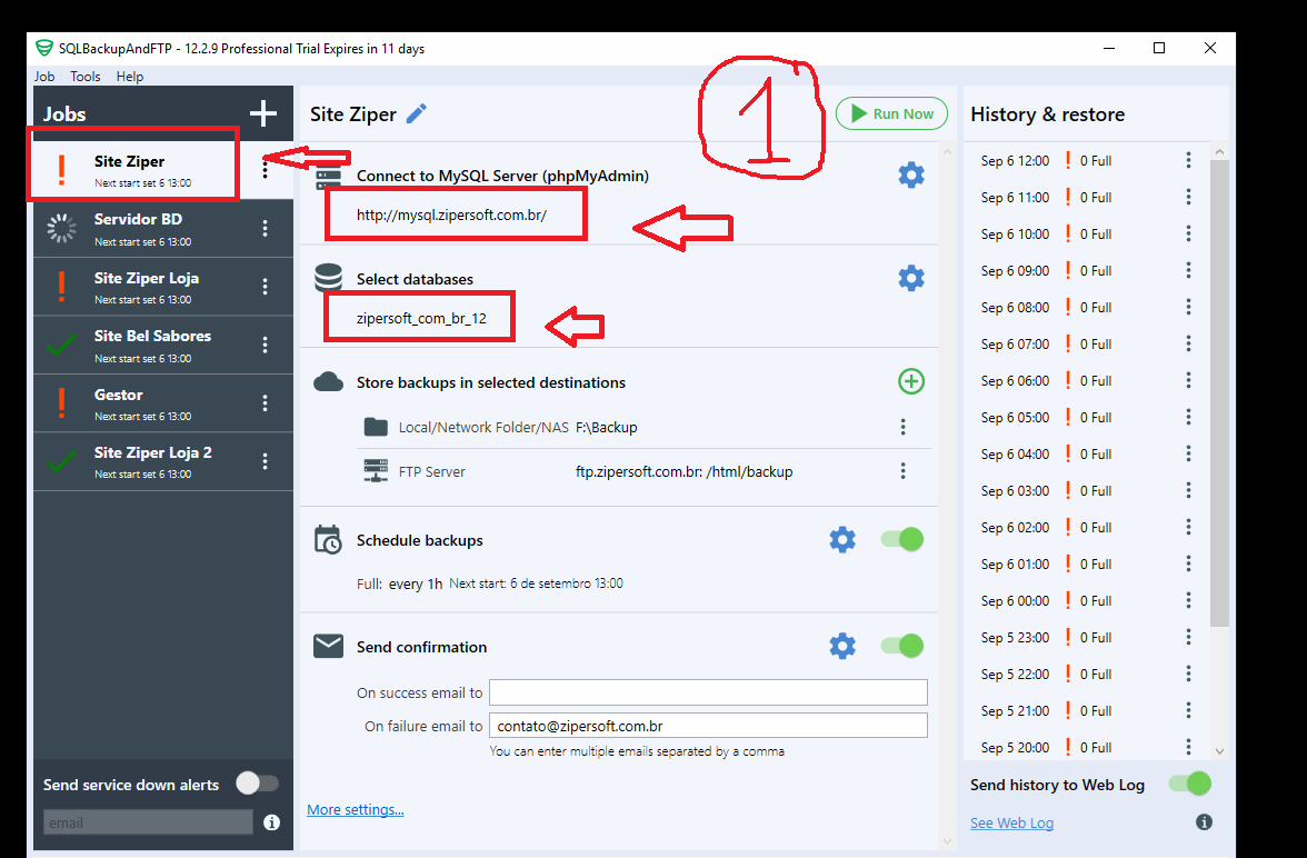

Hello Alexander
I am sending 4 images.
The error occurs because the 6 configured backups, 4 of them come from the same address “phpMyAdmin” as it is (http://mysql.zipersoft.com.br/) so just change the “username” and “password” of each database .
Because the databases are in the same location, the program loses and exchanges the default “username” and “password” one of them, and does not respect each database has a different “username” and “password”.

Hello I still could not fix the problem.
Caption to be able to post this answer respecting the guidelines of your site (http://mysql.zipersoft.com.br/ = PATH)
Following error images and the correct:
Type: Mysql (TCP / IP)
server: 191.5.59.14
door: 3306
user: manager
password: ****
ERROR
server: mysql.zipersoft.com.br
door: 3306
user: manager
password: ****
ERROR
Type: Mysql Server (phpMyAdmin) **
server: WAY
door: 3306
user: manager
password: ****
SUCCESS****
Now where the program gets lost and the connections error:
server: WAY
door: 3306
user: manager
password: ****
SUCCESS BUT LOSES AND MAKES CONNECTION CONFUSION
server: WAY
door: 3306
user: lojavirtual2
password: ****
server: WAY
door: 3306
user: siteziper
password: ****
server: WAY
door: 3306
user: lojaziper
password: ****
Note that these 4 databases are at the same address just separated by username and password, when you start backing up they get bogged down and get lost all and make the biggest mess of connections.

Hello, I did the test, but still the same problem, if you can record a video and upload or post to YouTube to see exactly what is going on. I am hoping to fix this problem for me to buy a full version.
Hi andrespilari,
Could you please send us a screenshot of the connection window? Also could you please clarify what server name do you use?
Please make sure you have specified your server’s name like
localhost /* any description of the connection */
Sorry for the inconvenience.
Hello follow the youtube link that shows the program error.
Hi andrespilari,
Appreciate your response with the detailed information!
Yes, that is how SQLBackupAndFTP works. But if you need to specify different credentials to establish the connection, please specify your URL like localhost /* any description of the connection */ and use the credentials you need.
Hello friend, now it worked, thank you very much for the help I will try to buy a license now the program.
