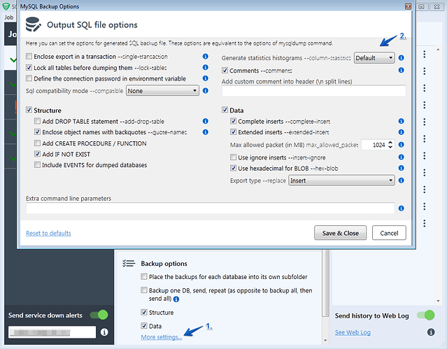

Thanks for the details. Could you please go to the “MySQL Backup Options” and set “Generate statistics histograms” to “Default” it should resolve the issue.

It works!!
Thank you very much!
