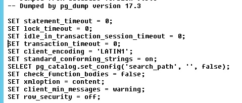

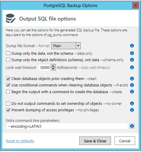

Hi, I updated the software to the latest version and I can’t get the restoration with the correct encoding.
I add as extra parameter --encoding=LATIN1 and make the backup.
The created backup file has correct encoding LATIN1:
captura2
Then I restore but the encoding remains as UTF8.
I try restore overwriting an existing database with encoding LATIN1 and drop the existing database to create new one; with both options I get encoding UTF8 after restore.

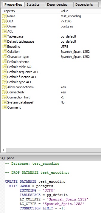

I also try create a db from scratch with:
– Database: test_encoding
– DROP DATABASE test_encoding;
CREATE DATABASE test_encoding
WITH OWNER = postgres
ENCODING = ‘LATIN1’
TABLESPACE = pg_default
LC_COLLATE = ‘C’
LC_CTYPE = ‘C’
CONNECTION LIMIT = -1;
And then backup (plain and custom settings) and the restore also change ENCODING, LC_COLLATE, and LC_CTYPE:
– Database: test_encoding2
– DROP DATABASE test_encoding2;
CREATE DATABASE test_encoding2
ENCODING = ‘UTF8’
LC_COLLATE = ‘Spanish_Spain.1252’
LC_CTYPE = ‘Spanish_Spain.1252’
