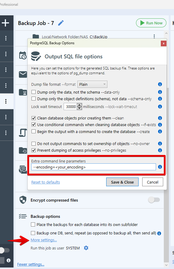

Hello Sebastián,
The error you encountered does appear to be related to character encoding. If the encoding used during the backup did not match the one used during the restore, it could cause data corruption or misinterpretation — as in your case.
To address this, please try specifying the correct encoding in the Extra command-line parameters field of your backup job settings by adding:
`--encoding=<your_encoding>`
You can find a list of valid PostgreSQL encoding values here:
:link:PostgreSQL: Documentation: 17: 23.3. Character Set Support
Additionaly, if you’re using an older version of the software, we recommend updating to the latest version, as several encoding-related improvements have been made over time.
