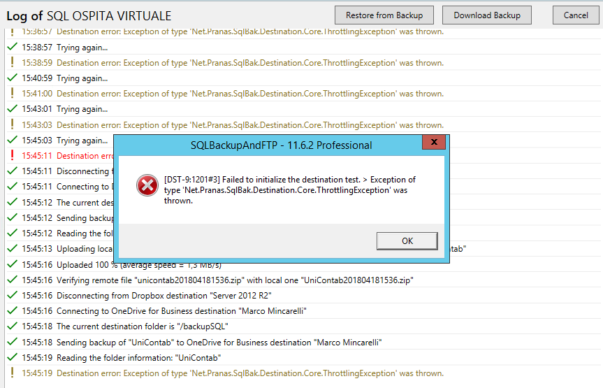

After pasting the authorization code of One Drive for Business and clicking “Connect” this error window appears:
I’m using the latest sqlbackupandftp version.
Please help me
After trying a few times to Connect One Drive for business connected but when I clic “Test” there I another error:
Hi, I need help, anyone with the same problem?

Thank you for the response but the issue is still there but with different error messages.
Screenshot:

I installed this new version but some issue i still running.
I backup 3 DB in the same job. For 2 small DB (< 5MB) there is no problem uploading in one drive for business.
For the bigger DB (diff > 20MB, full > 200 MB) the upload to ODFB works once yes and no without any rule.
I just sent to developers advanced log.
Just for adding that in the same backup job I upload the same DBs without issues.

Hi Alexander
I have already ran the upgrade and still getting the same error.
01/05/2018 11:25 Trying again…
01/05/2018 11:25 Destination error: [throtling:429] One Drive for Business throttled this request. Please try again in 120 seconds.
Thanks
Michelle
Hi Michelle,
Thanks for the details.
This error message is sent by One Drive for Business and we cannot resolve it from our side, sorry.
