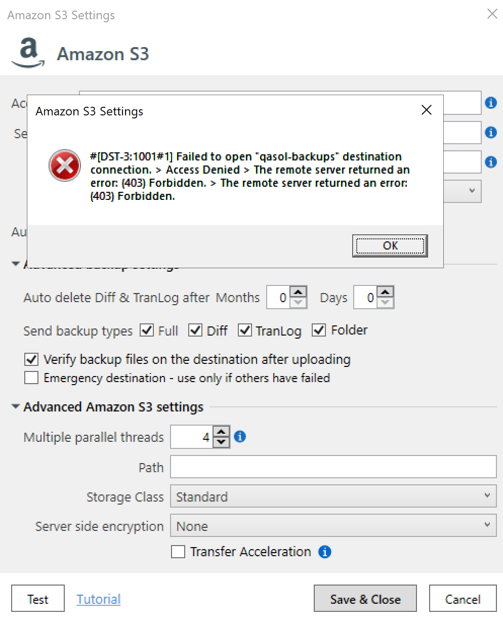

Hi there, i just installed SBF and and the AWS S3 as destination and got this error
Then i switch to S3 custom and filled the AWS S3 info and the test working, The test job working too.
