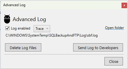

In order to see the full commands (with all used parameters), click Tools – Advanced Log… and enable the Trace level. Next, perform a backup or restore and search for the substring “Mysqldump parameters” or “The MySQL command” in the logs. These lines will contain all executions of the

These lines will show the exact command-line executions of mysql.exe and mysqldump.exe with all used parameters. That can help determine whether there’s anything unusual in the way the backup is triggered.
Advanced Log SQLBackupAndFTP
Let me know what you find, and I’d be happy to help analyze the log details.
