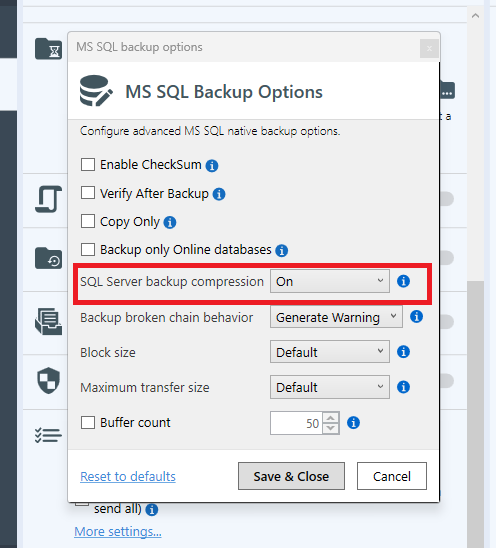

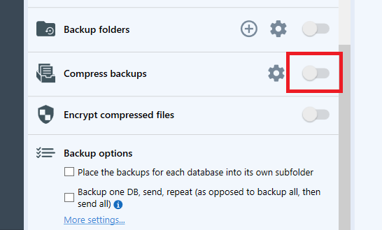

For a backup of this size, I would recommend trying a slightly different configuration: disable the ZIP compression step and enable native SQL Server backup compression instead.
Compression off
Native SQL Server compression should be significantly faster than creating and processing such a large ZIP archive and should also reduce the temporary disk space required.
Unless minimizing the final archive size is particularly important for you, I think this would be a better configuration for a 375+ GB database.
